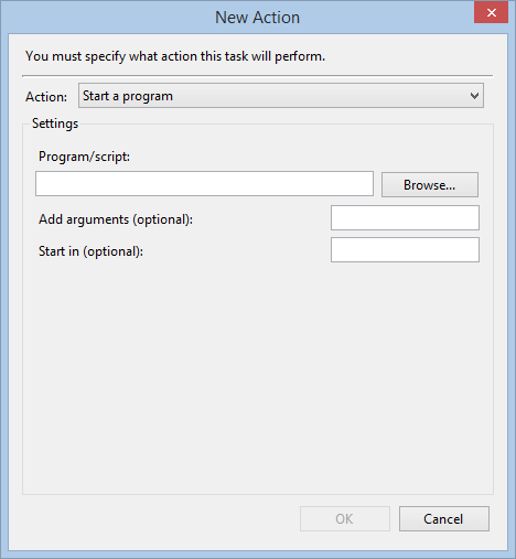

1) I want to automate this script on Windows (taskschd.msc).
How should I put the arguments in action to launch the script? And should we put winscp.com or winscp.exe?

Re: FTP to FTP / Backup and Upload between FTP (Batch Script)
1) See https://winscp.net/eng/docs/guide_schedule
2) WinSCP cannot generate folder names based on order of a week days. You would have to get the number outside of WinSCP and pass it to it. E.g. using an environment variable. Ultimately that means that you will be scheduling a batch file (or other script), not WinSCP directly. So part of 1) won't apply anymore.
