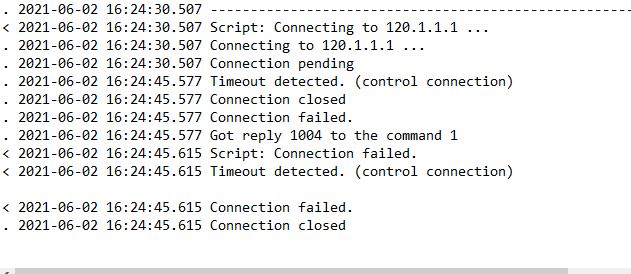

I'm guessing it's because winscp itself returns a 0, because when i'm looking at the log, there is no "Script : Exit code: X" as you can see.
I tried the same using /script with a txt instead of /command but the result is the same.

Re: Issues catching return code and %ERRORLEVEL%
Sure then, here it is.
  • FTP_4SAISONS_20210602.log (4.31 KB, Private file)
Indeed, it seems that the exit code is not logged in this scenario. I'll look into it.
