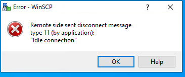

I found a way to script it by batch - unfortunately the sync session does not automatically close after finishing the job. I get the message "No differences found" if there are no differences which needs to be confirmed before the app terminates. This is really bad if you want to automate things. Is there a way to use sync jobs without prompting anything?
EDIT:
Additionally I get the following message from time to time and is not able to reconnect automatically... Seems /synchronize is not really good for automation...
Indeed, /synchronize is not for automation. For automation, use scripting and its synchronize command:
https://winscp.net/eng/docs/guide_automation
https://winscp.net/eng/docs/scriptcommand_synchronize
