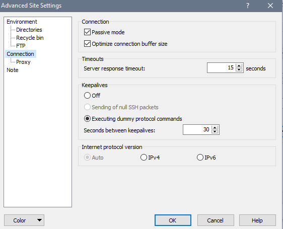

Re: Loosing connection repeatedly
I don't understand what you mean by "try the keepalives". I believe I've set it up properly, but I don't know how to "try" it. My connection parameters are as shown in the attachment.
I've now tried it with "keepalive" both checked and unchecked and get the same problem. I've talked with my website host and nothing has changed on their end in the past couple of weeks which is when I started running into the problem. Maybe I should completely uninstall, then install WinSCP? That would be a pain because I'll need to write down all my connection criteria.
You wrote before that "My keepalives button is not checked", so I've understood that you did not try it.
Anyway, if keepalives did not help, there's not much you can do on WinSCP side. Reinstalling won't help. If you want us to look further, please post a session log file with keepalives enabled. But I do not think we can help you much more here.
