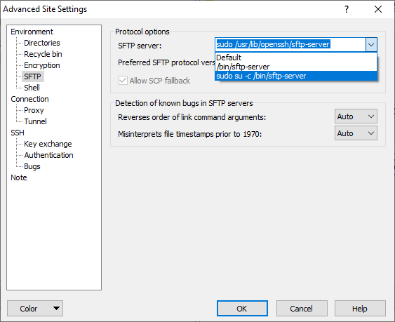

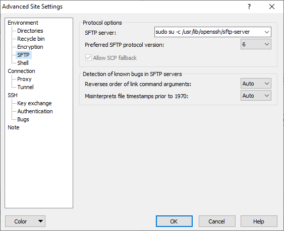

Added sudo su -c /usr/lib/openssh/sftp-server to the SFTP server field in the Advanced Site Settings. Screenshot below.

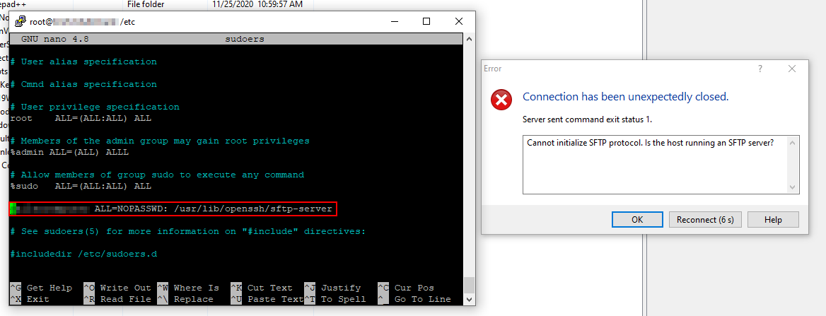

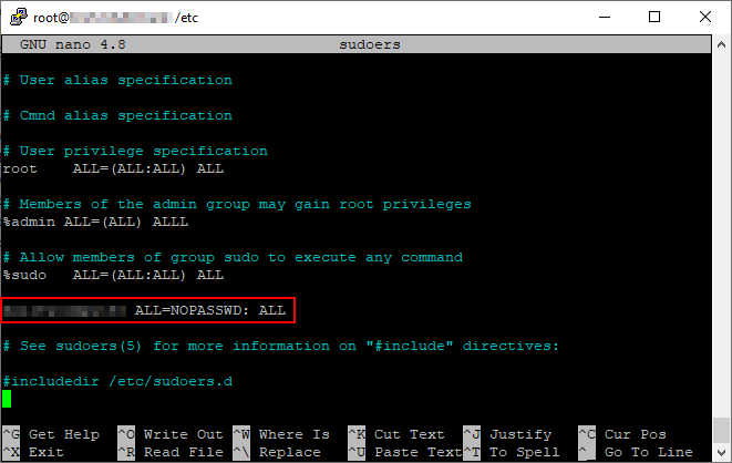

When I add [username] ALL=NOPASSWD: ALL to sudoers, WinSCP can connect just fine. Running sudo su -c /usr/lib/openssh/sftp-server via PuTTY session prompts for pw.
However, when I replace the above with [username] ALL=NOPASSWD: /usr/lib/openssh/sftp-server it will fail to connect. Screenshot below. Running sudo su -c /usr/lib/openssh/sftp-server via PuTTY session does not prompt for a password and starts the service.

I'm no expert in sudo, but when you do sudo su -c something, isn't the command that you add to sudoers the su -c something and not just something? I understand that you claim that it works on command-line – can you double check that?
Also, why sudo su -c /usr/lib/openssh/sftp-server and not just sudo /usr/lib/openssh/sftp-server?
Good question... I just modified the entry from the dropdown menu with the actual path to the sftp-server. I just changed it to sudo /usr/lib/openssh/sftp-server and it's now working fine.
