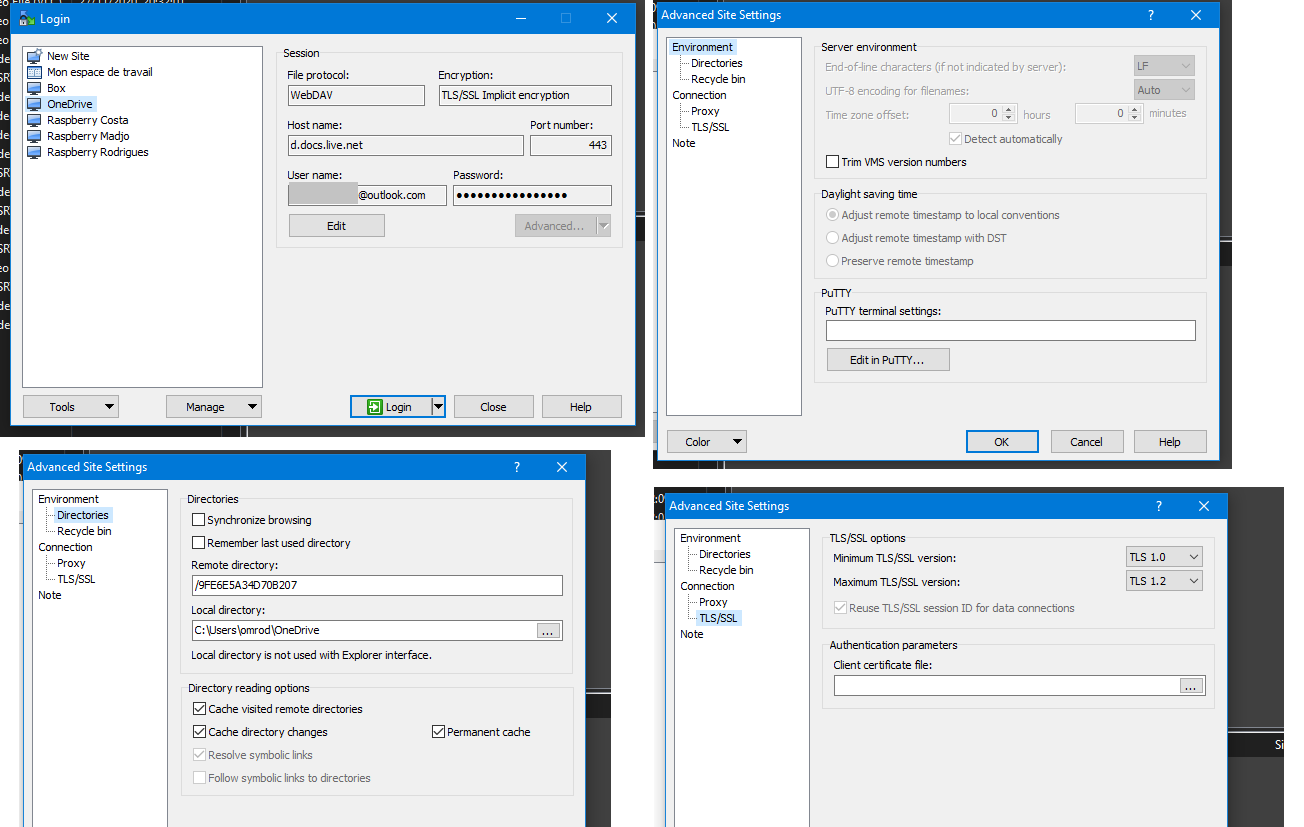

I used <invalid hyperlink removed by admin> post and I don't succeed in connecting, getting error:
Could not authenticate to server: Missing Authentication-Info header
La connexion a échouée.
Any tip please?
Thanks. O.

Trying to log but I don't succeed.
I don't see the option in WinSCP.
Then tried in command line like:
davs://prefix%40suffix@d.docs.live.net/path/ /log="C:\Temp\winscp.log" /loglevel=0
But no log is generated...
and still get the error message I put in attachment.
Cheers.
O.

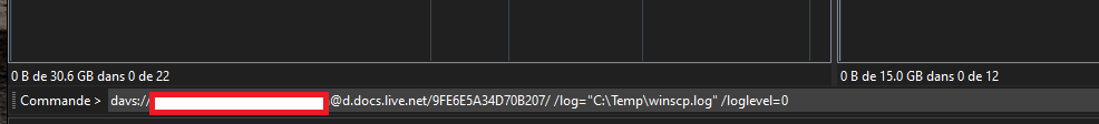

madjo1983
Re: Microsoft OneDrive with WebDAV
That's what I did:
not working...

Where did you do that? Show us a complete code/script/commandline, whatever you are doing.
I did it in in WinSCP command line...
