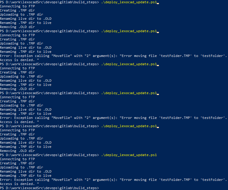

Hello, I have strange problem with WinSCP asssembly and powershell script. In script, I want to create tmp folder, upload files, rename old target directory, rename tmp to target and remove old. In first run, it works, in second run, library reports error
Access is denied
on folder, which created few moments ago. And on third run, it removes this folder, 4th run access denied, and so on.. Look into attachment, there is console and logs for good and bad run I can't find error, can someone help me?
Here is code:

Description: Console with multiple runs

Partial solve. Problem was when directory was not empty. I thought that MoveFile was recursive. So, there is no option to do atomic rename of big folder (rename only parent) and I have to rename all files or do SynchronizeDirectories? It leads to inconsistent directory for big folder.. It looks like I'll have to use something else. :(
