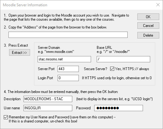

Stupidly(?), knowing that my Respondus Software -- https://web.respondus.com/he/respondus/ -- (which allows for the creation and uploading of tests directly into my course shell, I got the "brilliant" idea to use the login information from Respondus and enter it into WinSCP configuration (Respondus sends the test directly into my specific course -- and right into the module - section -- I want).

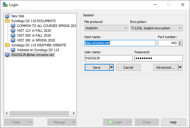

My problem -- I THINK that I am actually getting into the Moodle Room server using WinSCP using this information, but I am unable to upload any file ("Error Message 405 Method not allowed"). I know that this is an error on my part -- not your program -- but any clarification as to how to work around this problem would be greatly appreciated.

Description: Respondus Configuration screen
Description: Configuration details

Re: Log File
Sorry, I didn't notice. The server does not behave like a WebDAV server. Sorry, I do not know how to help you.
