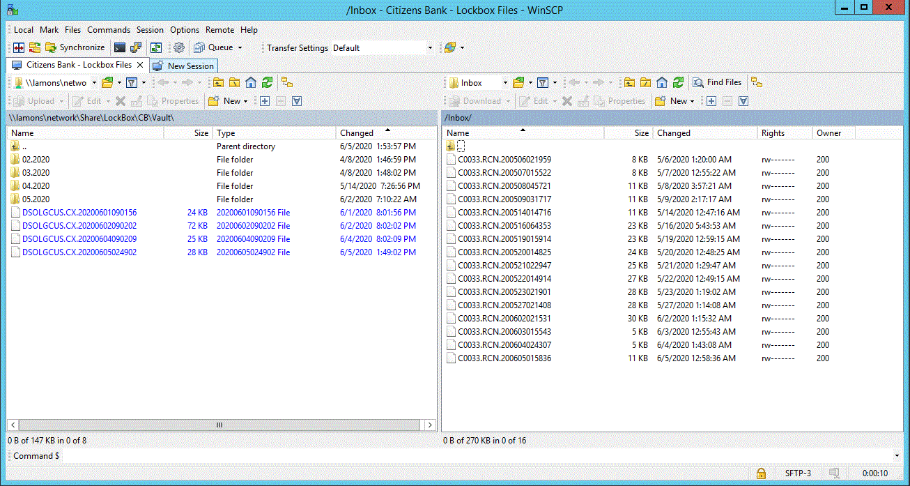

Hi Martin, I am attaching a screen shot of the GUI. The files in colored blue is what has been successfully downloaded from the GUI.
I am using Task Scheduler to launch a batch file.
My account is a Local Admin account and does have access to the folder.
Appreciate any insight you may have.
Description: Image of successful download from Remote site to local.
