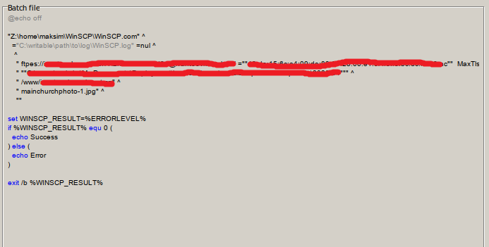

I also have noticed that script generation function doesn't work properly under Wine. It misses function names.
So, instead of showing "open ftpes://xxx", it shows " ftpes://", the same for "put *" => " *", "lcd <dir>" => " <dir>" etc.
The same for Batch, PowerShell, .NET Assembly code.
I guess that there's some internal error that WinSCP doesn't show in logs.

Please report the code generation problem to Wine.
