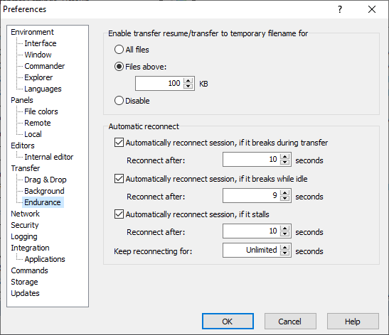

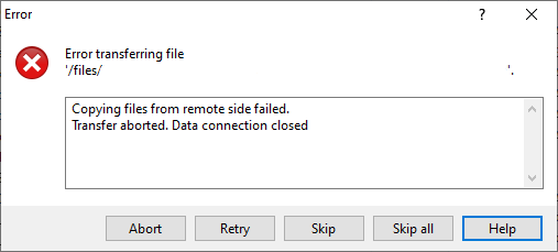

Whenever a transfer is failed and contains: "Copying files from remote side failed.", WinSCP do not do auto retry. Settings under "Endurance" in Preferences has all been set. There are screenshot attached for reference.
Is there any way I could make WinSCP do an auto retry? Or could this be a "feature request"?
Description: The endurance preferences

Description: Error dialog

Continuing this same topic, I am encountering the same issue. My package has been running fine for months, but now the last 3 days the process is bombing on the step to upload files. I have about 700-900 PDF files to upload once per day. When I do this manually through the interface there are about 20 files that result in the "Copying files to remote side failed" error. I can simply click "Retry" and it immediately works as expected and continues on until it reaches another problem file. I don't see any reason that these files would fail. I confirmed I can reach them and open them and they aren't corrupt or huge in size or anything.

They seem to be one in the same, but sure, let's please start with focusing on the GUI. When logged into the GUI and selecting 1000 files to copy over, I have to manually press "Retry" when one of the files encounters a temporary error. I press Retry and the process continues on as usual. Is there is way to configure an automatic Retry without user intervention?
