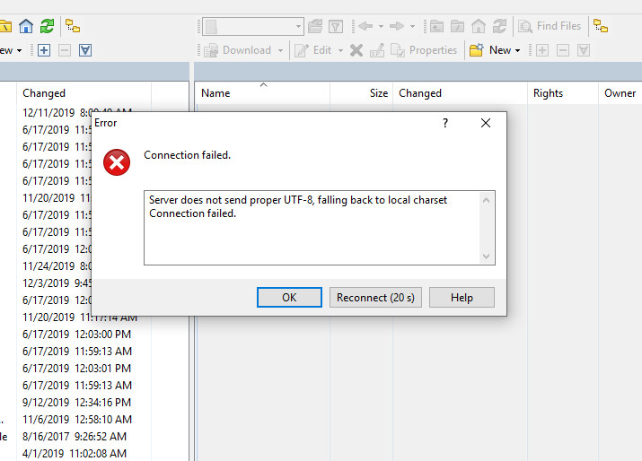

Hi Team,
We have setup FTP and we are able to login but few customers it was throughing an error as follows
"server does not send proper UTF-8,falling back to local charset connection failed"
Please assist me to resolve the same.

. 2019-12-16 17:06:11.060 Server does not send proper UTF-8, falling back to local charset
< 2019-12-16 17:06:11.060 ÿûÿû
< 2019-12-16 17:06:11.060 IFS SupportNet-US, IFS domain username and password required to login.
> 2019-12-16 17:06:11.060 AUTH TLS
> 2019-12-16 17:06:11.060 AUTH SSL
< 2019-12-16 17:06:11.132 Username:
. 2019-12-16 17:06:11.132 Connection failed.
. 2019-12-16 17:06:11.132 Got reply 1004 to the command 1
* 2019-12-16 17:06:11.175 (EFatal) Connection failed.
* 2019-12-16 17:06:11.175 Server does not send proper UTF-8, falling back to local charset
* 2019-12-16 17:06:11.175 Connection failed.

Re: server does not send proper UTF-8,falling back to local charset connection failed
The message is probably not really relevant to the actual problem.
Can you attach a log file from the latest version of WinSCP?
