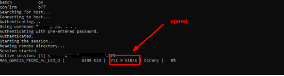

Hello All,
Previously I used batch script to upload files through sftp. In that we are able to view the file transfer speed for each files.
Now am trying to do the upload through powershell script. In that am unable to view the file transfer speed.
Anyone can help on this.
Description: Batch file
