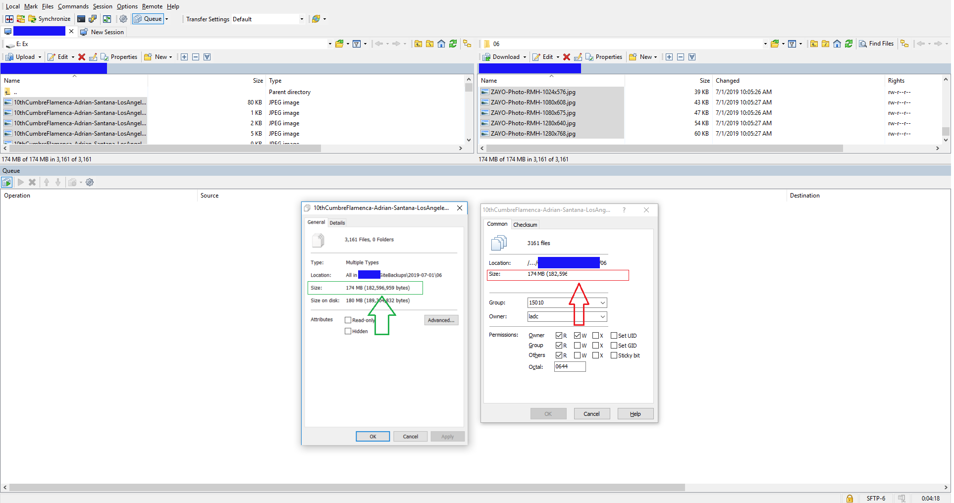

Other data I consider sensitive: I have Blue markups on the screen capture graphic where (hopefully) irrelevant data is redacted.

  1. Commander mode, select all local files in directory that I have just copied from remote directory
  2. Right click list of local files and select properties.
  3. Move resulting properties window to area below list of local files (in attached graphic, note markups I made, green arrow and box for correct file sizes)
  4. Select all remote files in remote directory
  5. Right click on remote files and select "Properties".
  6. Alt+Tab to return local files properties window to foreground and compare to remote.
  7. Note remote files properties number is not completely displayed (note markups I made, red arrow and box in attached graphic)

Description: Screenshot markups to demonstrate file size truncation
Re: Total size of remote files don't display completely in properties window
The layout of the dialog seems to be broken somehow.
There must be something specific about your machine/system.
Don't you have multiple displays? Did you try rebooting the machine?
