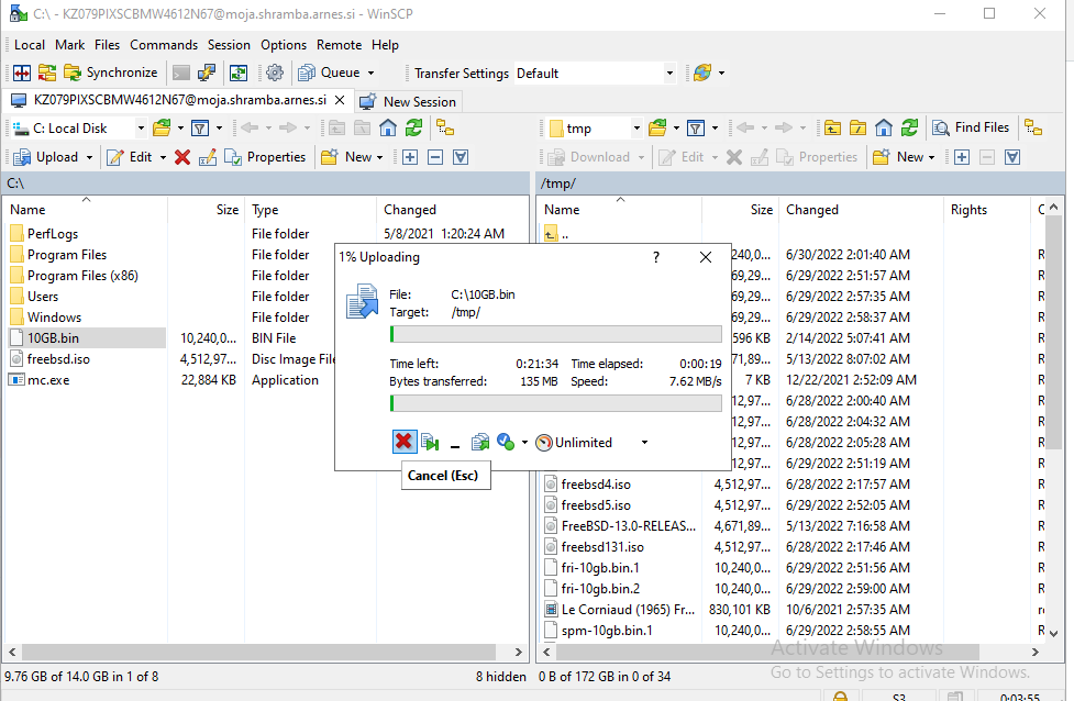

I am using WinSCP quite often to access different AWS S3 buckets which works very well and is easy to automate with the configuration file.
Now I have a use case where a user need to upload up to 5 TB of data. I noticed that the upload to S3 is normally between 7-8 MB/s. Sometimes its shortly up to 10 MB/s but not more. I have a 1 GBit/s internet connection so I assumed to get at least 70-80 MB/s in upload speed.
When I upload the files directly from aws cli it works like expected so my guess is that there is a bug/limit/whatever in WinSCP. Anyone can help me here? Perhpas there are some hidden configurations?

S3 transfert speed is lmimited to 10MB/s "by default"
Using WinSCP 6.5, when starting an S3 Upload or Download, speed is limited to 10MB/s
When "touching" the speed limitation button, to change from "unlimited" to "unlimited" (yeh.. the same...just to confirm you want max...) THEN, the speed limitation disappears...
so it's just a "default speed is wrong"......
