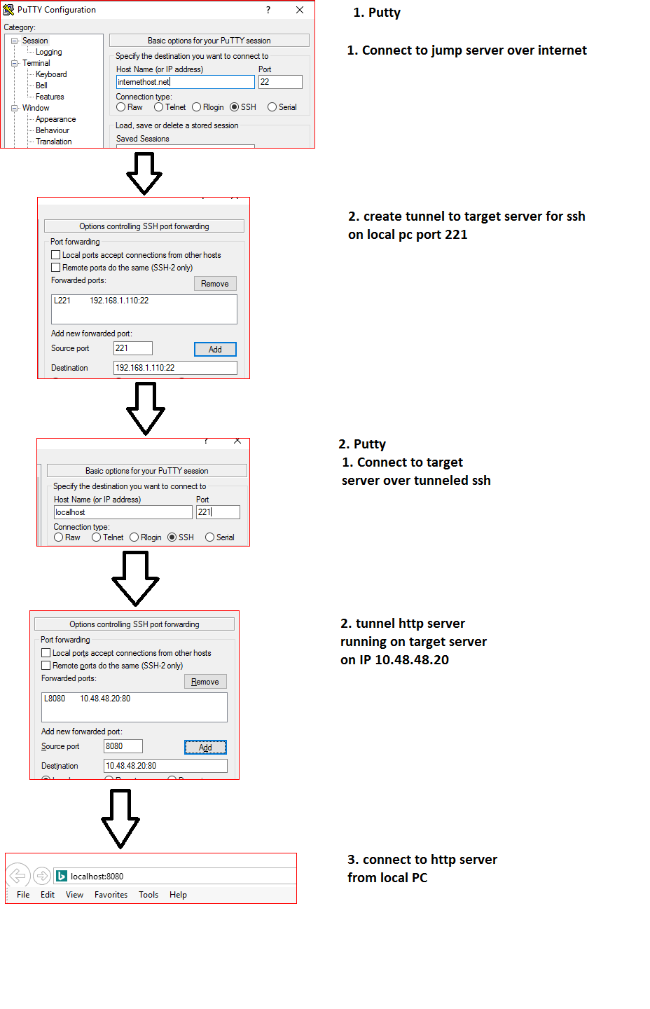

Hello
I use tunnel for ssh connectivity.
Internet(port 22) - > Jump Server (tunnel 22)-> server on local lan(22). It works fine.
I need connect to server in local lan on port e.g. 80 (port is running on different VLANs). Is it possible to add additional tunneling on that serveru? I use putty and I add ports manually. It is not so comfort because I have hundreds of ports ...
Thank you

ToldaCZ
Re: Open ssh tunnel in ssh tunnel
If I understand correctly, you want WinSCP to forward port (80) in addition to SSH port (22). WinSCP does not support this.
We will see, if more people ask for it.
I tried to explain with attached picture and Putty. I need add part 2. tunnel http server. Is it clear now?
OK, I understand now.
