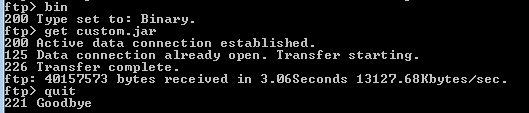

I just did some tests:
Win7 built-in FTP: 105 Mbits/sec
Filezilla:          60 Mbits/sec
WinSCP FTP:         40 Mbits/sec
For the Win7 screenshot below, 40157573 * 8 / 3.06 / 1000000 = 105 Mbits/sec
For the Filezilla screenshot, 7.3 * 8.192 = 60 Mbits/sec
Description: 40157573 * 8 / 3.06 / 1000000 = 105 Mbits/sec

OK, I tested again with a 512 MB file and timed it with my iPhone. (Transfer times were 38 to 72 seconds.) WinSCP did the same as Filezilla this time, 60 Mbits/sec. However, the built-in Win7 FTP command line did 112 Mbits/sec, which is the maximum for my Internet speed. So I wonder what they're doing differently. Buffer sizes? Multiple connections?
My post was not so much to complain about WinSCP but to ask if there's anything that can be done to make it faster. I remember when setting the TCP receive window was a big thing and could be calculated based on the maximum ping time and desired download speed. Are there any similar settings in WinSCP that could allow it to receive more data given the 35 msec ping time to the server?
