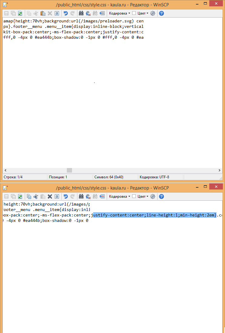

Hello, i have a problem with *.min.css files.

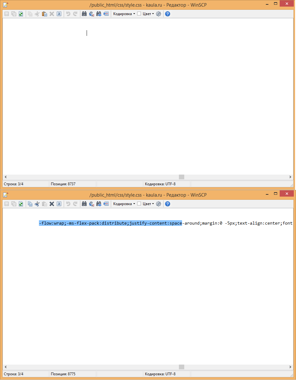

When code is min.css, I cant see code in editor, there is only empty area. If highlight empty area - i see code. But if remove highlight - again can't see the code.
This problem i saw only in *.min.css files (where everything is very close to each other and don't have spaces.)

At work I have win8 (rus loc)
At home I have win10 (1803 version / rus loc)
Yes, i have same problem when editing a local file.
I checked yesterday at home from Russian localization, then deleted the program and all settings and installed the last English version, the problem remained.
I changed "Preference - Editors" from "internal editor" to "notepad" and the problem is gone
