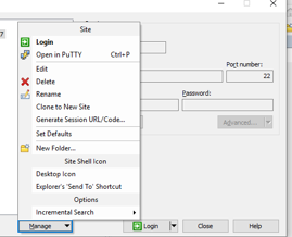

Where is the transfer setting in WinSCP? The only time I could see Transfer settings when I am trying to connect. It only shows me the script to connect but no other options. I have attached a screenshot.
