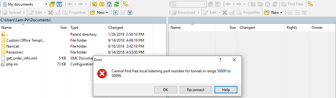

WinSCP's "Connect through SSH tunnel" feature stopped working after Windows 10 1809 update
WinSCP's "Connect through SSH tunnel" feature stopped working after Windows 10 1809 update.
It says:
Cannot find free local listening port number for tunnel in range 50000 to 50099
I rolled back to 1803 version and WinSCP works again.

I'm having the same problem where the connect through SSH tunnel stopped working after an update
I've tried versions 5.15, 5.15.1 and 5.13.9
Windows 10 version 1809 build 17763.437
The error is
Cannot find free local listening port number for tunnel in range 50000 to 50099.
When I look in TCPView, there aren't actually any ports used in that range.
If I set the port manually to 49999 (which is free) I get
Network error: Connection "127.0.0.1" refused.
I also tried running it as an Administrator.
If I manually set the port to 51000 it works.
