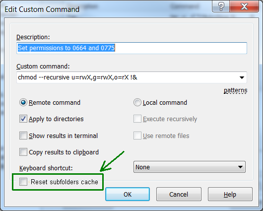

Perhaps adding to the "Edit Custom Command" dialog box a check box with the option "Reset subfolders cache" would be a solution for this problem and similars one's - see attached.
Description: "Edit Custom Command" dialog box - suggestion for modification
Thanks for your suggestion.
Will see if more people ask for this.
