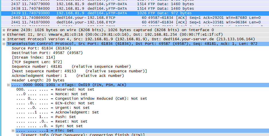

I assume I got the same Issue. Sometimes files are uploaded incompletely.
For example file 03.jpg has a size of 53.248 Bytes, after seemingly successful upload, size on the FTP-server is only 49152 bytes. After some investigation using wireshark it seems that WinSCP actually finishes the transfer after 49152 bytes (see attached screenshot). Could there be some internal error with handling files? Using Process Monitor it seems the local file is read in 4 batches and WinSCP somehow forgets about the last one (see other screenshot).
This was done using an older version of WinSCP and winscpnet.dll but the problem also occurs with the latest version and when starting the upload from the UI.

@martin.jakob: Can you send me an email, so I can send you back a debug version of WinSCP to track the problem? Please include link back to this topic in your email. Also note in this topic that you have sent the email. Thanks.
