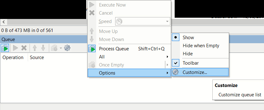

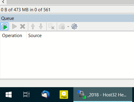

On the attached screenshot, you will see a blank area, the area where normally WinSCP logs the transfers to the remote server, be they in progress or finished.
However, since the update to the newer 5.14 beta, that field remains blank even after the successful upload of a file (and I'm given overwrite prompts because my goldfish memory can't confirm me whether I had already uploaded the file or not).
Commander interface. I first discovered it with my native French version, but still had it after switching to English and relaunching the program.
Program was downloaded from winscp.net, I'm not going for the windows store even if you threaten me with a pointy stick.
Sorry to bother with the bug news!

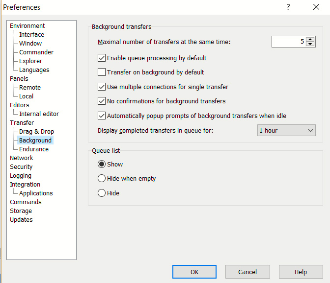

In case it may help debug, here are my transfer log options relevant to the issue (they're unchanged save one thing, I switched from "forever" to "one hour" to test, it didn't change anyhing), see the two attached images.

Only background transfers show on the queue. This was always this way. No change in 5.14.
oliverfr
Then might it be possible for some reason the transfer defaults changed with the upgrade to 5.14, and transfers ceased being background transfers?
Otherwise, well, it's the random weird thing that happens for no reason on a computer and it's no use worrying anyway, heh.
