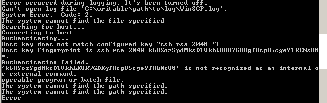

I have to automate file transfer from NAS path location to unix server. Have been using below code but its throwing error as mentioned below (Also not able to find the winscp.log file in my system, can it work without that, if not what can be the alternative approach):
code:
@echo off
/log="C:\writable\path\to\log\WinSCP.log" /ini=nul ^
/command ^
"open sftp://zapp:xxx@hostname/ -hostkey=""ssh-rsa 2048 k6KSozSpdMksDTVkhLKUR7GDKgTHspD5cgeYTRENsU8=""" ^
"put filename.txt /home/zapp/Testdir/filename_Test.txt" ^
"exit"
if %WINSCP_RESULT% equ 0 (
echo Success
) else (
echo Error
exit /b %WINSCP_RESULT%
Result:
Please find attachment.

1) I'm pretty sure that C:\writable\path\to\log\WinSCP.log is not a valid existing path on your system. Use a real path, instead of this placeholder.
2) Your batch file syntax is wrong. You cannot have an unescaped empty line between "open" and "put" lines.
3) It seems that you have a new line between "ssh-rsa 2048" and "k6KSozSpdMksDTVkhLKUR7GDKgTHspD5cgeYTRENsU8".
