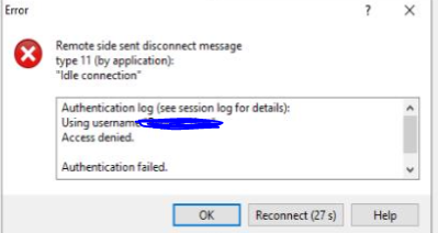

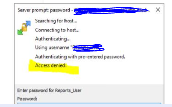

WinSCP type 11 Access denied error
Hi there, can you please help on how to solve WinSCP error "type 11"? I'm trying to upload file on SFTP. The issue is intermittent. First I was having time out errors and I extended the time out to 90 seconds. But now I get intermittent access denied errors on the logs please help attached is the screen shot of the error.
Re: Here is the log
I do not see any "type 11" error in the log. All I can see is that the authentication fails.
Also the log is overwritten. It looks like you are running multiple instances of WinSCP in parallel logging to the same file.
Soulja
So the type 11 error is shown on my first screen shot when I try to connect manually it fails and throws that type 11 error intermittently. Now the log is for when my SSIS packages using WinSCP to upload files I tried keeping the session alive, tried saving the URL, username and password the SSH nothing seems to work can you help on why the authentication is failing intermittently based on the logs I provided?
Is connecting to WinSCP simultaneously or parallel not allowed? I may have jobs that running on the same time trying to connect to it but no more than one or two jobs simultaneously?
If you get intermittent authentication failure, it's likely the server that does not like your frequent/parallel connections. Talk to your server administrator, it he/she can tell why the authentication is failing.

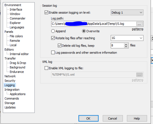

Setting logging to "overwrite" is no better. You should not log multiple paralel sessions to the same file. You can use !T and/or !P patterns to make the log file name more unique.
https://winscp.net/eng/docs/ui_pref_logging#session_log
