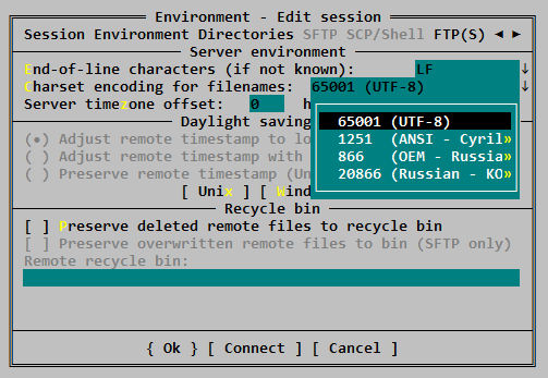

The description of this settings reads "Language for non-Unicode programs", hence it controls (perhaps among others) the set of glyphs to use in code positions 128-255 for console applications. WinSCP is Unicode program, hence it should not rely on this setting, or let's say, should fall back to it as a last resort. For example, NetBox (which is built in the top of WinSCP I believe) has a dedicated option for that.
I do not disagree. But there's a little demand for such an option. Most servers either speak UTF-8 or use an Ansi encoding of their users' language.
