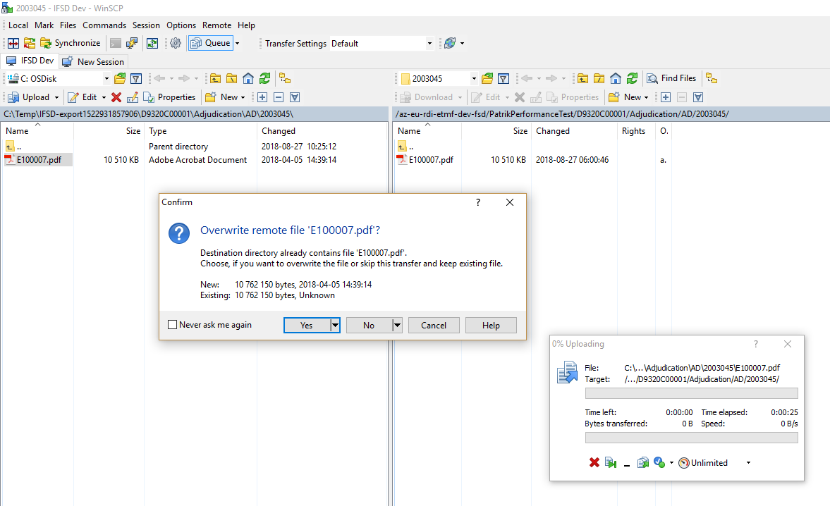

The New and updated files only option from the Transfer Setting Dialog is not working. When I upload the same file again(having older timestamp locally than remote) the file is not ignored but instead wrongly uploaded again.
It seems to be due to the timestamp from the remote file cannot be retrieved. Pls check attached picture.
using version 5.13.
not tested any previous version of the tool.
I am working on Windows 10
Transfer protocol is S3
Description: Picture showing missing timestamp for remote file in Overwrite Confirmation popup.

Log-file attached.
Attached is the log file.
The operation logged was one file uploaded. The transfer setting New and Updated only was checked.
The local file timestamp was 2017-04-05, the remote file timestamp was 2017-08-27. The file was upload even if the time was older locally compared to remote.
