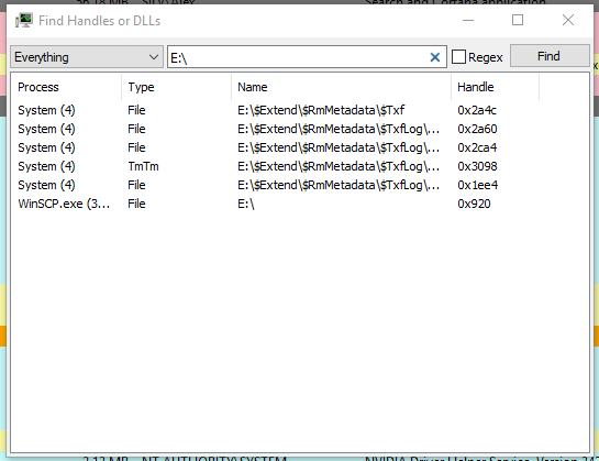

Later on I wanted to safely eject an USB memory drive with the letter "E" however Windows didn't allow me to because some application was using it. Since I didn't even use the drive I looked for opened handles and found WinSCP holding one.
After the transfers finished, closing the app freed the handle and allowed me to safely eject the other drive (note, both drives were connected to a hub connected to an USB port on the machine, not directly to it in case that's relevant).

Description: Opened handles for the drive "E", disregard the first ones as they're system related (they sometimes belong to the "Server" service, but not in this case; likely NTFS related).

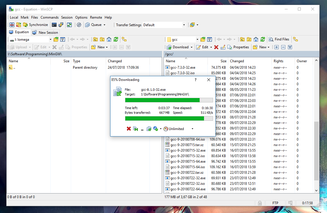

Description: WinSCP performing the task.
