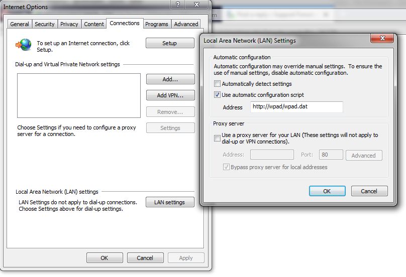

So this is what my proxy settings look like (see attached file)
I also tried unchecking "Use automatic configuration script" but that didn't solve the problem. Is there a way to configure WinSCP to use CONNECT as well?

If you uncheck that, does it prevent Cyberduck from connecting?
WinSCP cannot use automatic proxy configuration script.
You have to configure proxy manually:
https://winscp.net/eng/docs/ui_login_proxy

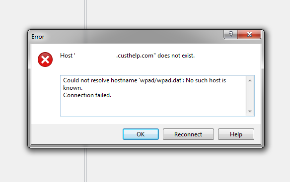

I also tried using that URL in the proxy settings of WinSCP
but got the following error (screenshot attached)
Am I doing it the wrong way?
I wrote that "WinSCP cannot use automatic proxy configuration script.".
Contact your network administrator to ask what proxy you need to use to connect to <sitename>.custhelp.com.
