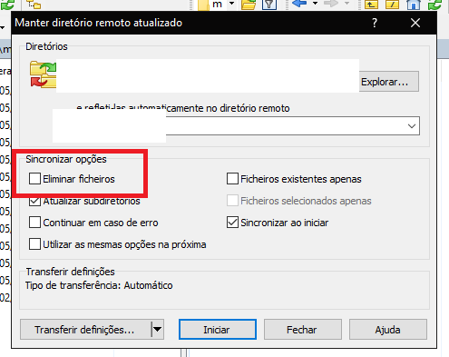

I would like an option to
delete files in the TARGET
(that do not exist in SOURCE)
only for the same FOLDERS name
on the SOURCE.
It's a merge deleting for existing directories in both side, deleting sub-directories and files that are not anymore in SOURCE.
I see that there is an option, but if I use it, it 'll delete the others directories in TARGET root.
Description: This option is not enough, because it would delete entire root.
43,067
Re: Sincronize and delete files on TARGET subdirectories only for folders/directories off the SOURCE
Do I understand right that you want to delete orphan files, but not orphan folders?
Cannot you just exclude the orphan folders from synchronization?
