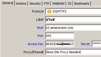

Setting a s3.us.amazonaws.com did not finds server name, because port 443 redirects to sub server.
We currently using CrossFTP and it works well with current settings - see attachement
Reply with quote E-mail
How do you change "country code" in CrossFTP?
US is S3 default. So do you have actually any reason to believe that your problem is about "country code"?
Special characters in the Secret access key should not be problem in WinSCP GUI (can be a problem in scripting).
Though the error message that you are getting indeed suggests that your credentials are wrong.
Are you able to login with WinSCP to S3 anyhow? (e.g. different set of credentials, different bucket, whatever)
