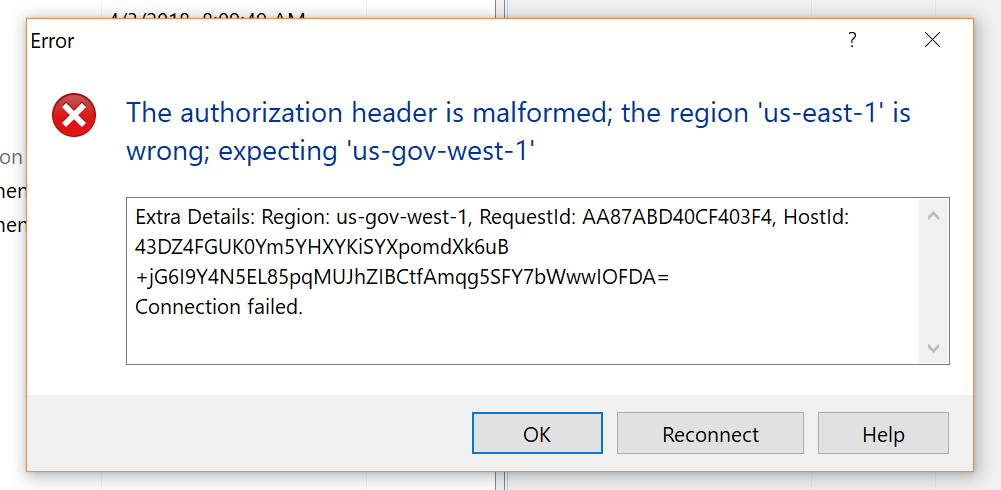

See attachment for error. The region key is not correct, and there is no way for me to specifiy it. Note that this occurs when using AWS GovCloud, which is isolated from normal AWS services.
Text of screenshot:
The authorization header is malformed; the region 'us-east-1' is wrong; expecting 'us-gov-west-1'
Extra Details: Region: us-gov-west-1, RequestId: AB3CB4671E441F7A, HostId: <...>
Connection failed.
Description: Screenshot of error
