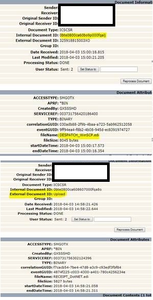

When I upload files using the WinSCP software, all is OK. When I use the dotNet library, copying the code taken from the Session info in WinSCP, all seems OK on my side - the files upload OK - but the customer claims it does not generate a unique 'External Document Id' (he calls it a SNRF, not sure if that means anything but they are French so could be French abbreviation).
I have attached the information received from the client. When using the WinSCP software, he gets a unique External Document Id (as per the top screen shot, even though he's highlighted Internal Document Id!).
When using the DotNet library, the 'External Document Id' is set to "Upload" (as per lower screen shot), which is the name of the sub-folder that the source file was in on our side prior to upload.

Description: Example of what is received by customer.
