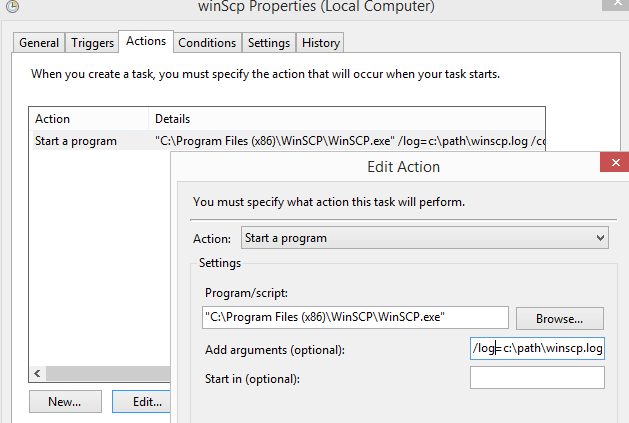

On Windows Task scheduler of 'Action tab' I chose to start a program and execute the WinSCP.exe and on 'Add arguments' section I used the script that I think will be used to save log files, establish connection and synchronize local to remote server as:
/log=c:\path\winscp.log /command "open sftp://xxxx:14001/ -hostkey="ssh-hrsa 2048 ...=" -privatekey="E:\AAA.ppk" -rawsettings ProxyPort=0" "synchronize local|remote|both [ E:\DailyLogs [ cd /BBBB ] ]" "exit"
However this didn't work as I expected and wondering if you can identify for me where my mistake is or any other ideas?
