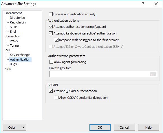

bkph@...
Re: Error code: 3 (works in WinSCP 5.9.6, but not later versions)
I think I may have found the problem. WinSCP 5.13 appears to have checked
"Attempt GSSAPI authentication" in the "Advanced Site Settings" by default.
Unchecking that appears to get me back to working mode. Thanks.
