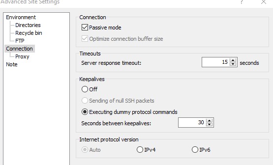

i have a passive option with can be ticked/unticked
glenhall wrote:
i always noticed this with winscp, when i compare downloading something with filezilla or the old flashFXP client, winSCP always seemed slower as if it was capped, so im glad i found this subject here, but when i go into my site manager/advanced, i can see the optimize option but its greyed out and i cant untick it.
The option is not available/relevant to FTP protocol.

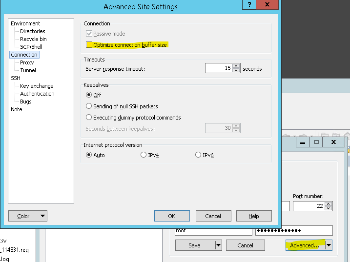

Re: can't find the settintgs
crazyluke wrote:
I have the same problem but can't fix it. Why?
I had some issues finding it as well. On the specific connection click the Advanced button and in the Advanced Site Settings window select Connection.
Under Connection uncheck Optimize connection buffer size.

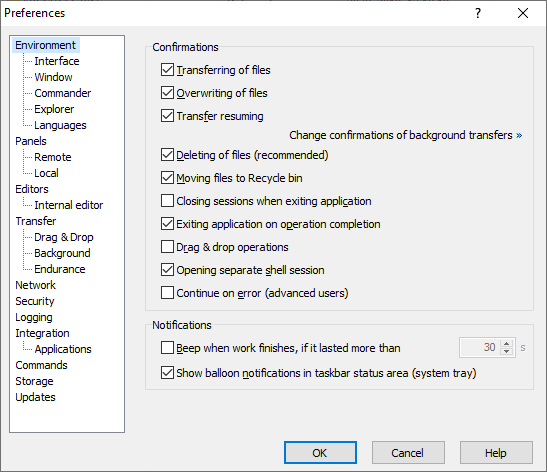

setting for latest version?
where does one find "Connection uncheck Optimize connection buffer size" setting for latest version? there's no connection settings listed on left like in the image?
Re: setting for latest version?
the corey's wrote:
The issue when I do it is that option is greyed out, how do I get passed that part?
The option is mostly relevant for SFTP and SCP protocols only. What protocol are you using?

Just an idea. People shouldn't have to figure this stuff out =)
