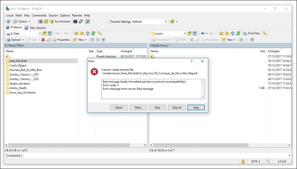

I'm now attempting to remotely upload new CD's via my Windows 10 machine, using WinSCP (my preferred approach) .
(WinSCP Successfully used in the past with Vortexbox for downloading ripped CD's albeit running on a dual core Dell Vostro)
I continue to get the following error message from WinSCP after performing a CD copy
"Bad message (badly formatted packets or protocol incompatibility) Error Code 5 , Error from Server : Bad Message." See attached example image.
The fail is not instant though , a number of FLAC tracks appear to be copied before WinSCP complains, the result being a partially transferred / uploaded CD

Description: Track position/error. But don't believe the track to have a problem as it playsback fine on another Squeezebox install.
