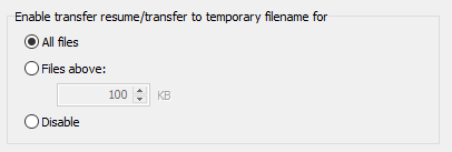

Using 5.17 and noticed if you fail a transfer to remote file, for whatever reasons, it deletes the original remote file. Say editing a config file and then re-uploading, which is what I was doing, it fails to upload, giving a vague reason and listing possible reasons for the failure and then promptly deletes the config file. So now I can't even redownload and re-edit the original config file because it's been deleted and must start all over again from scratch since the file is not even in any of the temp locations in %tmp% or %temp% so I can't just re-open a saved local copy and go from there.
U
It looks like temporary file transfer was already enabled at the time for all files(See attachment), so why did it still delete the config file?
@U: Please attach a full session log file showing the problem (using the latest version of WinSCP).
