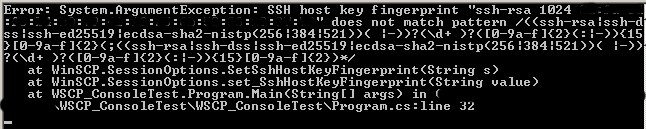

Hello All,
I’m trying to connect to a server via SFTP w/ fingerprint and it throws with the reason stated as “SSH Host fingerprint does not match pattern, as you can see on the screenshot attached.
According to what I see in the mentioned pattern, it expects only 256/384/512 bit fingerprints; moreover, there’s a typo there (521 instead of 512).
Thank you for your attention.
Description: Screenshot of the exception message.

You misinterpret the regular expression. The 1024 is not the problem.
Show us your full fingerprint. It's fingerprint of a public key. It's not a secret.
And the 521 is not a typo.

The full key is:
ssh-rsa 1024 0d:fa:ed:f3:b4:bO:79:41:1f:25:6b:58:36:19:97:73
That is exactly what PuTTY returns me when I try to connect manually.
