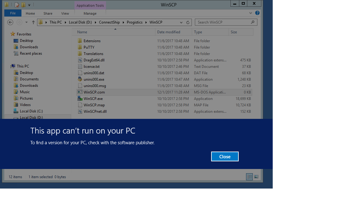

When I try to run winscp.com on win Server 2012 R2, I get an error saying that it is incompatible with This version of Windows.
What can be done?

What version of WinSCP? What is the exact error message? Can post a screenshot?

Thank you for responding so quickly.

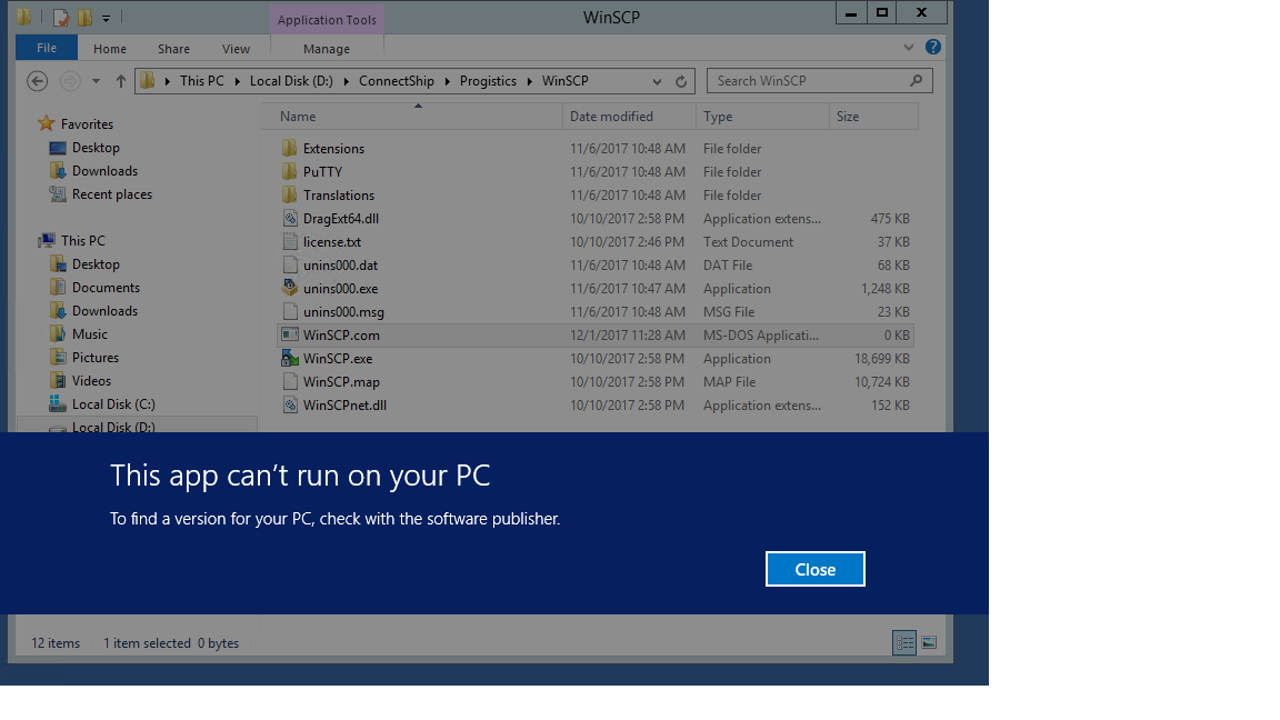

Here are 2 screen shots of different errors showing the same thing. Version is 5.11.2
Description: From control panel Version 5.11.2
Description: When I try to add from scripting, i get this in the other program.
Description: This is when I double-click on the winscp.com file.

The file is obviously corrupted. Note the "0 KB".
winscp.com version 5.11.2 has about 278 KB.
Try to reinstall WinSCP.

Thank you. I did that and SUCCESS!!!.
