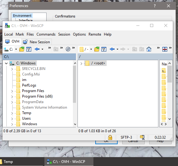

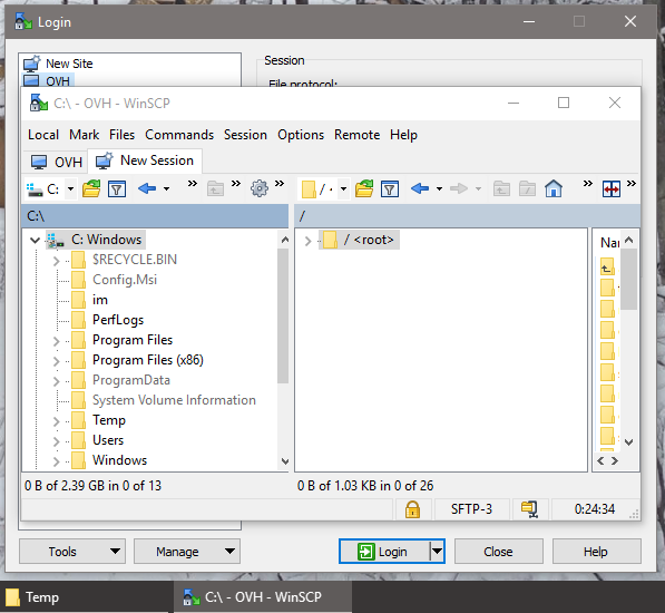

here is the log/screenshots

but after that clicking on "New Session" or "Options > Preferences" will send the dialogue boxes (focused) behind the main window.
Its impossible know what is going on if you have winscp maximised and nothing is clickable in main window as it is focused on the background box, the only way to get out it press enter/esc blindly to close the box.
Re-opening winscp it will make everything normal.
Screenshots attached.
Only these two? Or all dialog boxes?
Do I understand right, this happens only after WinSCP reconnects after the PC resumed from sleep? And it never recovers, so you have to close WinSCP. Correct?
