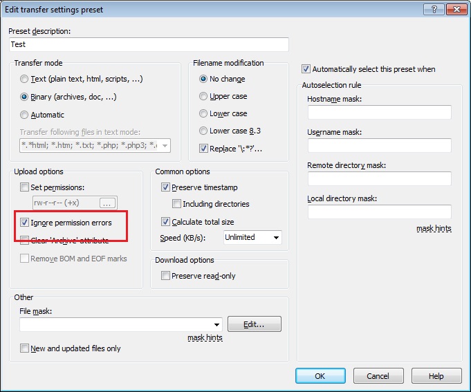

In a VBS Script I need to set Ignore Permission Errors to True, similar to the attached or dialog below:
Can somebody give me the syntax and the enumerated value? I assume in this case it would just be True or False.
IE:
transferOptions.IgnorePermissionsErrors = True?
Thanks!
Description: Ignore Permissions Dialog

I just tried this: It didn't cause an error, but it didn't update the property / setting:
transferOptions.AddRawSettings("IgnorePermErrors") = 1
(edited in 2022 by admin)
In the Session Log I am getting this:
. Script: put  -nopermissions -nopreservetime -transfer="binary"
Thanks!

Re: Ignore Permission Errors
OK, so without parenthesis.
transferOptions.AddRawSettings "Interface\CopyParam\IgnorePermErrors", "1"
