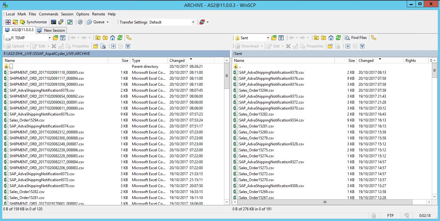

I've attached an image of the gui, in the /sent tab on the right hand side, the changed column only shows the files in hh:MM.
I've attached a log file, the file in question is SHIPMENT_ORD_20171017125346_008758.csv, you can see the copy routine runs at 11:53:55.176 and completes at 11:53:55.304. The file gets added to the folder with the timestamp of 11:53:59, when the copy routine runs 15mins later at 12:08:56.120 it excludes the file. In the log file the timestamp is 11:53AM only.
