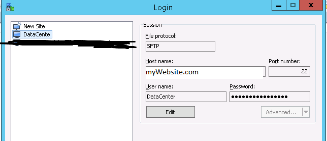

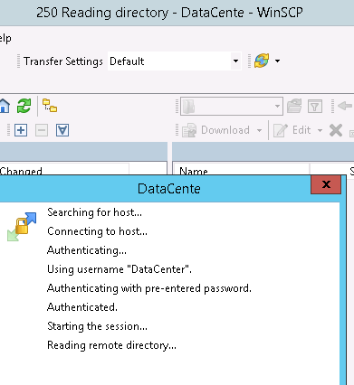

I get a strange behavior on our server.
When I try to connect to mywebsite.com via winscp.exe all is fine, it's listing thousands of folders and all is ok.
