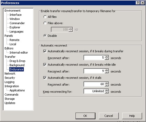

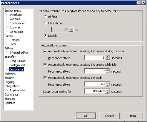

The syntax didn't generate an error, however, it still didn't resolve my problem. I am still getting the .filepart files created and the file transfer is not completing properly. Just a additional piece of information, the host has only granted execute and write security on the folder we are uploading to. I believe this is why WinSCP is not able to reassemble the .filepart extensions back to the original file, because there is no read access to the folder on the host (which I am not sure why they do this, except for multiple clients upload to the same folder??)..
As in the previous thread, I attached the screen shot of the settings we need that work correctly when transferring the file via the WinSCP Client UI. Again just need to know how to accomplish the same functionality when scripting through VB Script.
Thanks!
