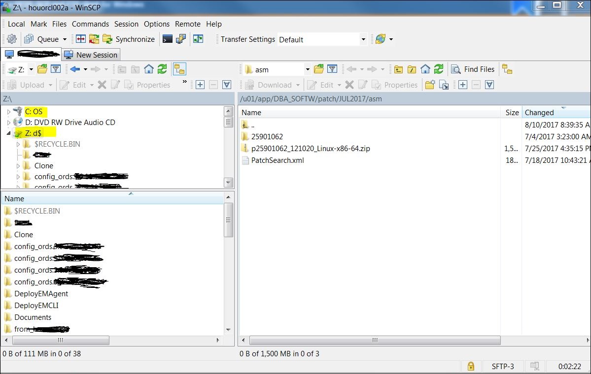

I am testing winscp against smartcard configured on servers. When WINCSCP Launched with SmartCard "runas.exe /smartcard /user:<username!> <winscp.exe_location>', it opened WinSCP window. on the right side of WINSCP window, I can only see Local drive C:\ directory on Laptop or Desktop. It does not see Network Map Drive or not able to do UNC path under the Location profile for Local Directory.
I would like to find out will there be UNC Path ("\\<server_name>\<drive$>" or Map Drive "net use \\<server_name>\<drive$>" allow for Local Directory when WinSCP Launch with SmartCard? I will have to login using Smartcard on UNC Path.

The console window runs with Administrator privileges. Do you also run WinSCP with Administrator privileges? What happens if you run WinSCP from the same console that shows all the drives?

Hi Martin,
Administrator with Window Authentication works and will see all map drives as well as local drive.
However with SMARTCARD (2 Factor Authentication), I cannot see map drives. I can only local drive. Think this is due to restriction when using SMARTCARD(2 Factor Authentication).

I'm sorry, but I got lost.
What I was asking you to try: Run WinSCP from a console cmd.exe window, where you can see all the mapped drives. Will you see the drives in WinSCP then? Can you post a (single) screenshot showing both cmd.exe and WinSCP windows and how you run WinSCP?
