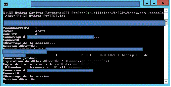

I have a batch that doesn't exit and reconnect indefinitely.
The Batch:
option reconnecttime 1
option batch abort
option confirm off
OPEN ftp://xxxx:yyyy@ftp.wwww.com -passive
LCD "D:\"
PUT "xxxxx.zip"
CLOSE
exit
The Result:
In the attached image.
Why doesn't the script auto abort? I am using option batch abort. Am I missing something ?

Same here
Hi, i got the same problem.
The option command is not working.
Connecting to ftp.XXXXXXX.com ...
TLS connection established. Waiting for welcome message...
Connected
Starting the session...
Session started.
Active session: [1] XXXXXXXXX@ftp.XXXXXXXX.com
batch abort
reconnecttime 120
FILE | 0 B | 0,0 KB/s | binary | 0%
Lost connection.
Timeout detected. (control connection)
(A)bort, (R)econnect (0 s): Reconnect <<<<=== WHY???
Connecting to ftp.XXXXXXXX.com ...
Tracker Bug 1169 only solved "Do not indefinitely retry transfer with FTP protocol when opening transfer channel is failing" problem.
If the problem is NOT while opening but after (e.g. Lost connection), there still is infinite retry.
https://winscp.net/tracker/1169
Kind regards, Mark
