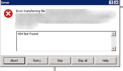

I have an issue downloading the files when connecting to macOS Server with WebDAV. I can connect, browse, but if I need to download or upload there is an issue. I get file not found, which is not true as the file is there. It must be some connection protocol handshake issue.

Can you download the file using any other WebDAV client?

Please find attached the log file

I forgot to let you know that I had no issue to get the file with ForkLift on Mac or the Finder on Mac

Can you post their log files?I forgot to let you know that I had no issue to get the file with ForkLift on Mac or the Finder on Mac

That was to navigate to a file and copy it. This is ForkLift log file

Thanks. But that's a different file. I need logs from WinSCP and ForkLift showing an attempt to download the same file.

Not that it makes any difference, but here are your two logs of the same file:

Thanks. It indeed did not help.
Can you do a Wireshark capture of both sessions?

Thanks for the captures. Though the connection is encrypted, so it does not help yet. Can you connect using encrypted connection? Or enable unecrypted connection temporarily, if disabled? Or use Wireshark dissector? https://wiki.wireshark.org/TLS

Unfortunately this is beyond me. I rather not touch the SSL and wireshark I do not get it what I am supposed to do with it.
