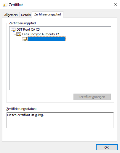

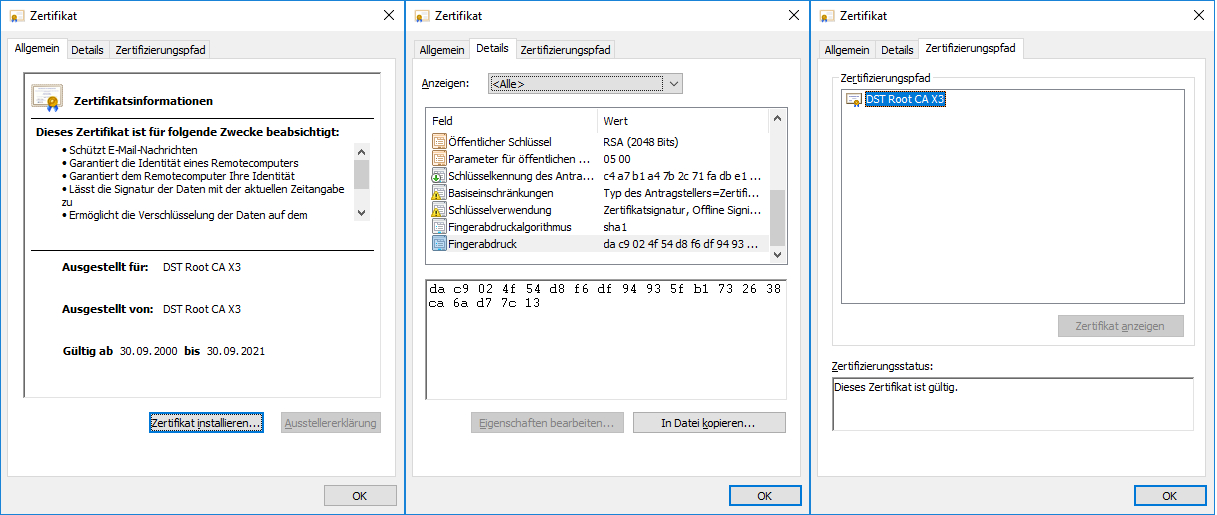

Hello Martin,
I obviously found a heavy bug. As short as possible:
An intermediate certificate is not trusted (and so the whole server certificate), when it's only referenced through the root CA and not stored within the "trusted intermediate CAs".
When you take the root CA certificate, put it into a cacert.pem aside a winscp.exe (which normally isn't there), the complete chain is trusted.
I assume, when a cacert.pem exists, WinSCP lets OpenSSL check the trust and doesn't use Windows Cert Store.
This is proof enough for me that it only depends on WinSCPs certificate handling when using windows cert store and it's not a bad ftp server configuration.
But anyway, all information and documentation you should need I'll give you with a lot of files:
Prisma
9
Which info do you else need?
If you use your own let's encrypt certificate, it should be easy to reproduce.
But via PM I could also give you more un-anonymized info if needed.
This is rather urgent, because our old certificate will become invalid in short and we want to use let's encrypt in future.
