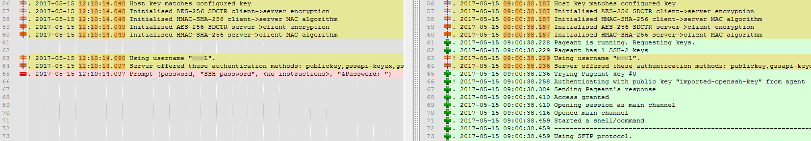

xiSlickix
I have almost the exact same scenario. Rather than placing files on a server, I am pulling new files twice a day. The same situation where I generated a private / public key combination, gave the public key to the SFTP server admin, and have a passphrase on my private key.
I have scripted a batch file that moves old log and purchase order text files from one directory to another, then calls WinSCP to do a one way sync (see attached scripts). If I manually run PO-SYNC-TRANSFER-CLEANUP2.cmd everything executes fine. If I have windows task scheduler run the same command (with admin priv, etc.) the process fails.
Pageant seems to be the missing link here.
